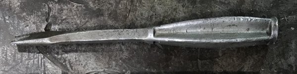

I got this with some other old tools. It was blackish and had some rust, but overnight in used Evaporust got it quite shiny.
In the mad rush of the first second opening of a tool related garage sale I thought it was a screwdriver. However, the tip is not screwdriver-like, it is thick and more the shape of an extremely dull chisel. The tool is also bent as if someone had pried with it.
I could not find any names, numbers or logos on it.
Any ideas?

I have the same exact tool. Bought at a flea market for $5. I have no clue what its for. Been used to scrape out grout between tiles.
1982fxr
Jan 7, 2012
10,012
Phoenix
Prison shank.
The handle is the plunger/stop out of a bathroom sink. Chisel end probably stolen from a contractor.
30,675
Leviton,
It is an extra heavy duty machinists' screwdriver. I have a Fairmount, BHM, and a few others. The fins are for strength and turning leverage. You will also see them in the so-called "perfect handle" style with a hex shoulder for turning. I'm on vacation and on my phone or I would post GJ links to examples and catalog excerpts I have previously posted. If you use the search tool and search on those terms more examples will come up.

Hey everybody, thanks for all the great information. And yes, this is a very substantial tool - it's heavy.
With the semi-pointed edge I'm thinking someone ground the tip to be a sharpened prying tool or rough chisel.
I sure enjoy finds like this where I can learn a lot and hold a piece with history. Imagine all the hands that have held it over the years and all the things it has worked on. A lot of enjoyment for 50 cents.
