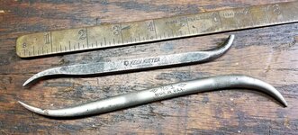

Toolmaker51
Nov 26, 2015
176
Missouri
A first, I saw a striker - drawn over wet mortar in brickwork. Solid versions cut better than stampings. But there'd be little reason for the inch scale along the handle section. Reading accurate info from tool companies said "cotter pin puller".
Potentially decent prybar on the square end, but curved hole alignment tool? That's not going to work well, likely being heat-treated and small, not ideal for a shearing load.

Biggest cotter pin puller? Normal one for scale.
We see BIG cotter pins occasionally, in a display, never installed. There's a shop somewhere breeding cotter pin pullers, a few grow up to be pry bars, runts are hoof picks for equestrians.
