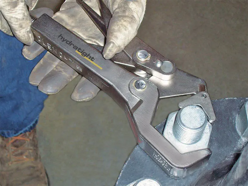

I’m going through a bucket of vise grips I got and came across this pair of Clench pliers? I’ve tried to do some research on what this is or would be used for. I have came across a pair on eBay that looks like it that says they are adjustable wrench?

Something similar
https://www.directindustry.com/prod/hydratight/product-53249-1722057.html
seber
May 31, 2016
4,231
Deep East Tx.
Adjustable striker wrench. Not only replaces a full set of strikers but eliminates the slip on softer nuts.

Ok I was coming up with the same eBay listing. Are these used in the assembly of metal buildings? Any idea what something like this is worth? Don’t think I will ever work with any nuts this big

Back up wrench, per the patent

N-S-W / N-S-W Corp, Houston, TX / hydraulic torque wrench / patent 2972918 Feb 28 1961 O.C. Huff and Walter J. Belanger Jr. and Donald F. Burnett & 3706244 Dec 19 1972 Claude H. Wilmeth & 3964352 Jun 22 1976 Bobby Wayne Dukes / see also B.K. Sweeney Mfg. Co., Denver, CO; see also Enerpac Tool Group Corp., Menomonee Falls, WI /
Sweeney / B.K. Sweeney Mfg. Co., 6300 E. 44th Ave., Denver, CO / est. 1901 closed 1977 / aircraft assembly and repair tools / patent 2773574 Dec 11 1956 & 3076362 Feb 5 1963 Edward T. Able & 3964352 Jun 22 1976 Bobby Wayne Dukes /
Enerpac / Enerpac Tool Group Corp., N86 W12500 Westbrook Crossing, Menomonee Falls, WI 53501 / https://www.enerpac.com/ / est. 1910 (as Hydraulic Tool Co.) / patent 3964352 Jun 22 1976 Bobby Wayne Dukes / see also N-S-W Corp, Houston, TX; see also B.K. Sweeney Mfg. Co., Denver, CO /

We have a machine at work that looks like the one in post 8 that is for hydraulic tensioning of large studs, typically 1-1/4 diameter. The machine stretches the stud hydraulicly, installs the nut at a low torque value, then releases the tension on the stud. This keeps you from having to use large torque values as the stretch achieves the same result. I don't remember who made the tensioning machine, but it was an oil services company in TX. Maybe this wrench is used to snug up the nuts in a similar hydraulic tensioning operation?
Not in DATAMP
So adjustable wrench?
13,520
You assume I read the patent. I was multi tasking I'm sure.
Ok, here is the key bit.
Such an operation may often require two operators, but when another operator is unavailable, or when space precludes the use of two operators, special nut and bolt holding devices, known as "back-up" wrenches, are used. To prevent the bolt from rotating, the back-up wrench is placed on the first nut and allowed to bear against and be supported by the next adjacent nut.
So this prevents trying to use a Crescent type wrench, and hoping it stays in place while you turn the other nut on a piece of all thread, holding an oil field sized pipe flange together
Clamping adjustable wrench.(y)
