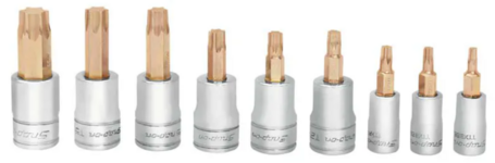

I was looking for the shortest T27 bit socket I could find. Turns out, KOKEN had it. I'm impressed by the quality. Very sharp Torx points.

What size bits do Snap-on gold torx bits use and can you use them on cheaper socket bit holders?
This thread is all over the place and I added to that :geek: but to answer your original question:
T15-T40 are 1/4 hex, T45 and T50 are 5/16 hex, and the T55 is 7/16 hex.
Snap-on does a raised dimpled deformation (looks like a little round circle) that retains the bits when pressed in, and that prevents them from being used interchangeably in a bit holder. But I have grinded that off and used as a normal bit.
