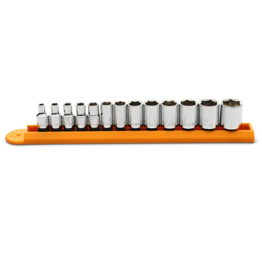

The short answer is Gearwrench.
Their socket rails have individual plastic square drive retention clips with a friction ball in each one.
They retain the socket very well while at the same time allow for easy removal.
And then on top of that, the socket rails are so wide that the socket set stands straight up on a level surface.
