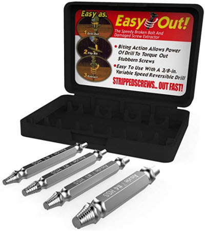

"Easy Out" is actually a brand name but like 'Kleenex' is used to refer to a different style of screw extractor for small screws that have a drill side, or burnisher side, that you use in a drill in reverse first and then flip them around to use the spiral extractor side, also in reverse at a very slow speed.
The spiral screw extractors in the OP are for larger screws or bolts you need to drill out a hole for them first (best to use a left-hand bit if you have one) and then use the spiral extractor in a tap handle or I prefer a tap socket on a breaker bar / ratchet. If you sent me for an 'easy out' I would not return with this style of extractor. They're totally different animals.
