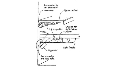

I did this and eliminated most of the holes in my backsplash.
Wouldn’t load for me due cookies etc. Spam like.
If this is wire mold from cabinets above it looks great when just complete. No outlets in the splash. Then you move in and plug your devices in and forever see chords dangling from above.
