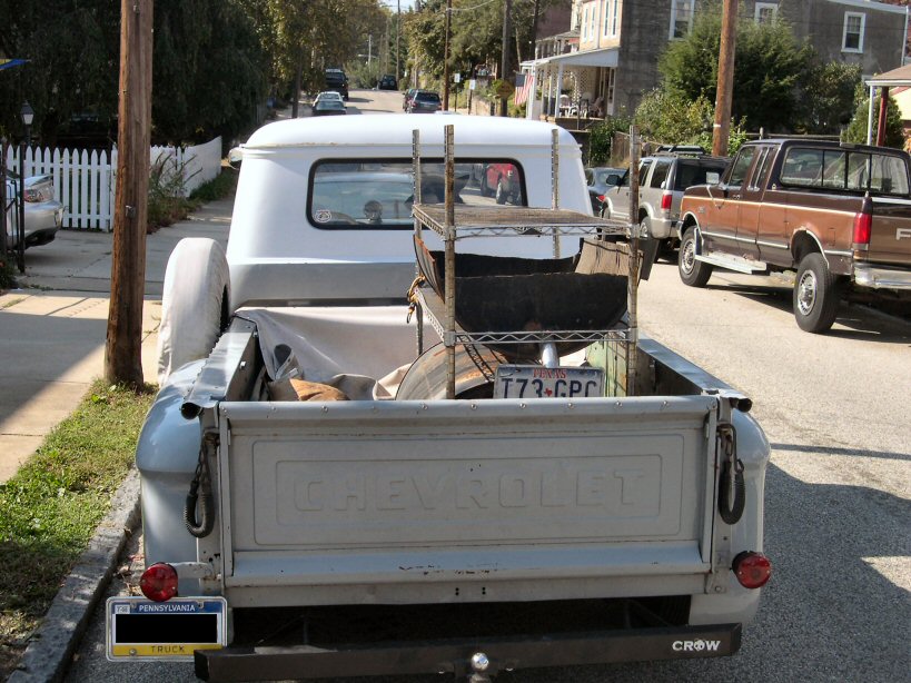

I made a BBQ with mine. Bottom most shelf is for bags of briquettes. Middel shelf has a rectangle cut out with half 55g barrel welded in. The cut out piece was then put back in the barrel to support the briquettes so there'd be proper flue effect. Note the position of the filler cap at the bottom to draw air.
Top shelf is the grilling surface. I drilled some holes in the vertical bars so the the rack can be easily be positioned at the proper height with pins. The rack is almost two feet longer than the barrel underneath. This allows you to move finished food, or food still be cooked, off the side.
The other half the barrel can be placed on top of the rack when needed to keep heat in.
I've served many a huge meal with this one.
Three of us made it in about an hour one weekend before a party. Beer in hand, of course. No safety police need apply.
