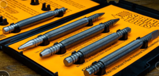

I have one of these with a recessed head, keeps the nail in line. Middle one in this pic. The set is currently not available.
I also have a little plastic tongs with holes for holding nails. Kinda like using needle nose, but with holes so they slide easier.
But yeah, you can probably push them in using a needle nose pliers, then finish with a nailset. OR a Spring tools nailset

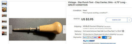

the tool you are needing is a "brad pusher" and there are literally hundreds of them listed on ebay.
I own an "Oxwall" and another no-name model and just purchased a "Star" because it was ridiculously cheap. I think I got this one for $1.95 (not $3.95) along with a couple old tape measures.
You will want to be very careful inserting and driving the pin for that well cup - don't bang the thing with the heel of your hand or you might distort the thin metal stamping.
Unless you are in the upholstery business, it is a tool you are going to use ONCE in this lifetime. (Please don't ask me why I own three - I have no clue.) Do NOT pay a lot of money for one - find a nice used one online and beat 'em down on the price.
The ebay sellers peddling their Hummel figurines and souvenir ashtrays have NO clue what these things are, so you will find them listed with all sorts of descriptions. Note that mine was listed as a "punch tool". Start your search with "brad pusher"/"used"/"made in USA"/ on ebay.
just my two cents.

[edit] RE: RTM's "Spring Tools" punches:
game changer. you'll toss your old center punches in the scrap bin. seriously.
Noxon / Noxon, Inc. DBA Spring Tools, 2921 No. University, Spokane, WA 99206 (also Spring Line Inc.) / http://springtools.shptron.com/ / est. 1993 / patent 5307741 May 3 1994 & 5426858 Jun 27 1995 & 5433007 Jul 18 1995 Emory J. Clark and Robert J. Warner / TM 86209086 Feb 11 2021 / center punches, nail sets / https://www.spokesman.com/stories/2018/mar/02/inventor-emory-clarks-swring-finds-therapeutic-app/ / https://www.garagejournal.com/forum...inc-emory-j-clark-spokane-wa-01-15-22.492380/ /
