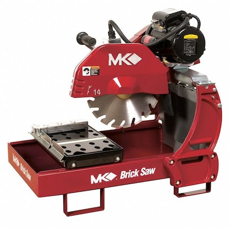

Hey all,
So I have some future projects planned. One is to redo a retaining wall that is currently railroad ties with no deadman (nice lean to it) with block and to extend our paver patio. No specific time table yet, but thinking about keeping an eye out for an appropriate saw on craigslist. Since whenever I actually need something, none are listed or ridiculously priced.
Looking at a saw that meets both needs. I see a few 14" wet saws listed like these:
But is that overkill for patio pavers? Can this saw do retaining wall blocks easily? I have debated the 10" HF Tile/Brick saw as an option, but I think it won't help me with the retaining wall blocks.....
Suggestions/comments?
Thanks!

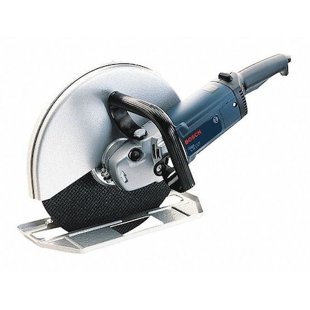

I use a 14" bosch cut off saw. I've cut hundreds of pavers and retaining wall block, a dozen or so basement windows and doors, and a lot of flat work. Used it twice in the last month to cut holes for ductwork in a basement wall. Makes a lot of dust, so I wear a good respirator. Of course, a face shield and ear protection also. A wet saw will work better for paver, but it's not as versatile.
I also use the cut off saw for cutting rebar, and for cutting cast iron pipe. Have cut a little bit of other steel also. It's a heavy beast at about 30 pounds. After you hold it up against a basement wall for 5 minutes you'd swear it weighs 75 pounds.
https://www.zoro.com/bosch-abrasive-cut-off-machine-metal-14-india-1365/i/G6157891/?gclid=CJOF_8b64dMCFYpgfgodX8YDXw&gclsrc=aw.ds
https://www.zoro.com/bosch-abrasive...gclid=CJOF_8b64dMCFYpgfgodX8YDXw&gclsrc=aw.ds
And I thought I was the only idiot to own one of those evil things. My dad bought that thing 30+years ago. And it still works just like it was brand new. If a man uses it all day, his *** is whopped. It does a fantastic job on block and brick. I went to a gas powered saw due to wet conditions I work in.
