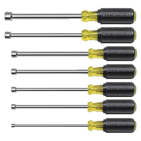

I've always used socket with extensions instead of having dedicated nut drivers, but I'm finding myself dealing more and more with 8mm and 10mm screws around tight places, and my new tool box needs some new tools :drool:
I checked out some at the box stores, but they're not comfortable to grip.
Came across these on amazon http://www.amazon.com/dp/B0000DD3CQ/?tag=atomicindus08-20
What are you favorite nut drivers for precision and feel?

I think you almost found the ideal nut drivers, except I would go with the hollow shaft model in the same brand, that way you can undo or tighten nuts on long threaded shafts

Try to find one and check the grip out.
Many people, myself included, find those style grips uncomfortable and NOT the ideal nut driver they are made out to be.
I perfer the older Craftsman nutdrivers that have the same style rubber grip as the Klein's but with the entire grip the proper color code.
I do agree, get the hollow shaft drivers on whatever brand you buy.
