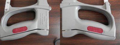

My favorite one is a beam hacksaw. This was branded by Milwaukee 48-08-0320, and it looks like it was discontinued. Too bad because I think it's one of the best designs of any hacksaw.
The beam is very sturdy, and is 1/2" x 1" thick and runs the full length of the hacksaw. You can really crank up the tension because the entire back part of the handle acts as lever that pulls on a threaded bar that connects to the front of the hacksaw.
There is a tension gauge so you can dial in your tension and maintain consistency when changing blades. There is a robust hand guard, and I can't tell you how many times that has saved me from banging into the work.
It also has a 45 degree anvil for angled cuts.
I think there are others like this from other companies. Maybe Proto or Greenlee had them but I can't remember for sure.
In any event, if you see one of these at a tool swap, grab it. You won't be sorry.
I've had one of those for about 15 years now, haven't found a better one yet.
