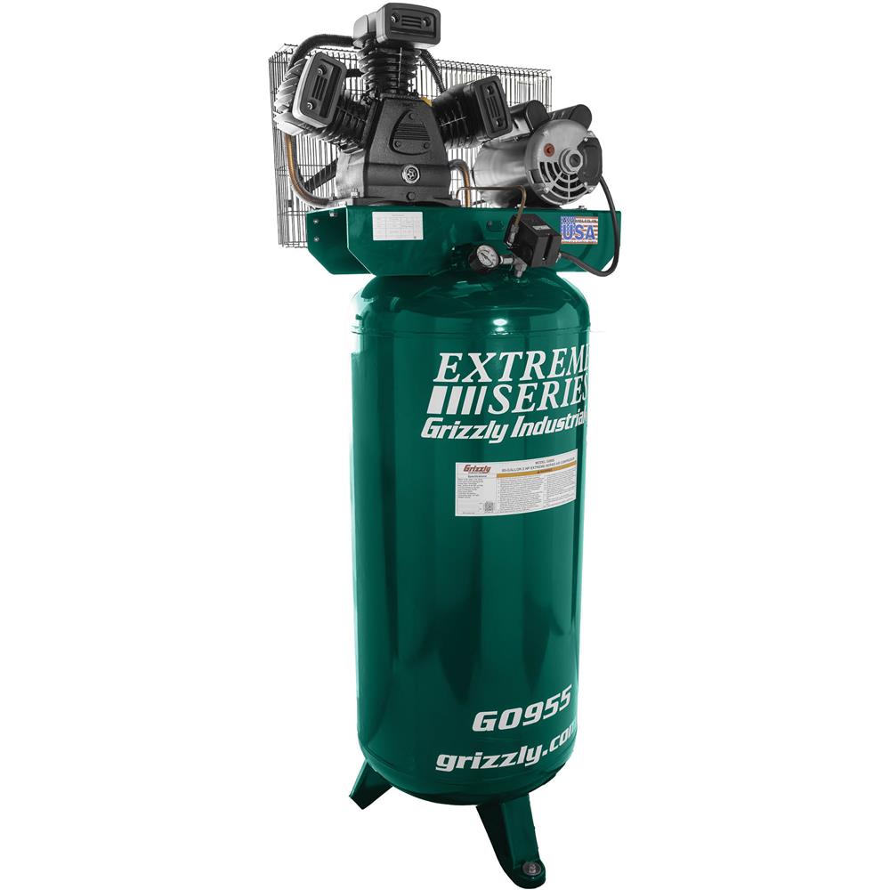

Lots of great info, I was just looking at this one from Grizzly, not sure who makes it for them.

That looks like a single stage compressor. There's no problem with that if it fits your needs, I'm just making sure you're aware.
