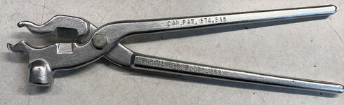

I don't have any experience with the UTI pliers linked above.
However, I've used these Snap on wheel weight pliers for about 20 years and always thought they were perfect aside from their price. :lol:
