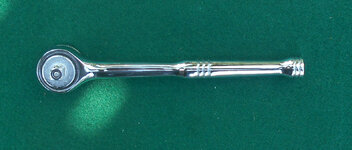

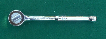

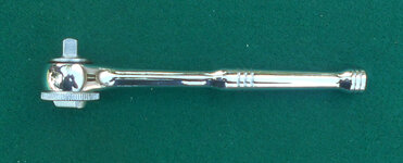

30,002
Using the "search" function, I come up with no fewer than eighteen pages of search results when I type in "Husky" and search "title only".
@OldTuleGuy has attempted to direct the "Vintage" Husky discussion HERE, leaving all that other Husky out there scattered about in a bazillion different threads.
I believe we've determined that these "Husky" branded ratchets which are not marked with COO were outsourced offshore, presumably from Taiwan, correct?
Husky 20202 /14" drive RHFT Quick-Release ratchet w/thumbwheel
