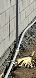

I thought you can’t run romex in conduit? Also they used tees for each of the runs upwards. Gets me also why they couldn’t have just ran the conduit at the top of the wall instead of the branches up from the ground. Also creative heating up the conduit to bend the top.

Romex is completely fine in conduit, indoors. It's not allowed outdoors at all.
The conduit thing is an internet urban legend.
Heating pvc conduit to bend is also normal. you can do some incredible stuff with a heat blanket
Edit now that there are pics.
That's a shitshow.

Without context of what that wall is, I'm not sure I see an issue.
Edit: 2nd pic in post 1 now visible

I see two possible problems. 1) The whole thing is wrong if the PVC is on the outside of the wall and 2) If on the inside, the T's can't be under the slab and it sure looks like that might be case to me.
As far as Romex in PVC, it's fine and bending with heat makes for an easier pull than factory glued on fittings.

I thought conduit underground is considered a wet location and thus NM-B would be inappropriate?
No way that bottom part of the conduit isn't going to be covered with dirt.

Where is this? WTF is it for? Judging by the ditch in the picture, that has to be on the outside of the outside wall. The whole thing is wrong, but it's probably in some location with a do it all inspector that doesn't know any better. Or no inspector at all. I love how people say "there ain't no codes here". Just because there isn't anyone to enforce them doesn't mean they don't exist. It's possible that the contractor doesn't know either.

the more I look at it, the more it looks like a privacy wall
That's all I can see it being.
Why else would they half *** route the PVC to the center of the block?
Begs the question though, what will hide the PVC?

no code prohibition on NM-b in conduit INDOORS. urban legend code book rule that wont die... however its prohibited in conduit outdoors which is what you have... so yeah needs to be ripped out

Sorry didn’t get a better pic, but they used sprinkler tees.
It is an exterior wall they put up for privacy and wanted lights on it. Backside they don’t see.
This is permanent, not temporary.

You may want to clue your neighbor in on the fact that they are paying for an effed up job. There is absolutely nothing correct about it. Did the block layers do that? I'll give them an A for effort, but if it goes on as is, those lights won't be working within the next 10 years. The Romex is going to rot out inside the pipe.

Besides the wrong wire being used outside, the other issue is the horrible gaps and missing concrete at the joints of a lot of the blocks. I guess if this is just a single privacy wall it doesn't really matter. But that wall, with all those gaps in the seams between the blocks, is not going to be very strong if there are high wind gusts around there.
