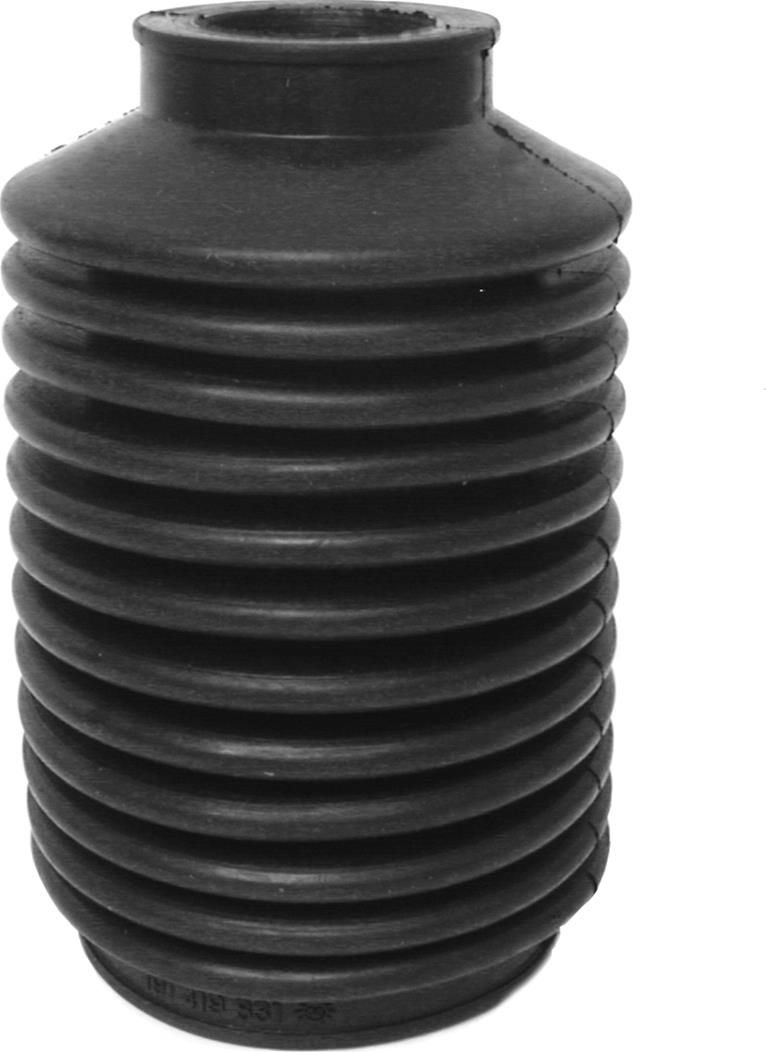

The one concern I've had since I owned it, it is that the boot had ripped. It was super dry, like it rotted out and almost started crumbling.
Given how much I like the jack and want to protect it, since there's nothing comparable out there, I want to replace the dust boot.
I've seen those CV axle boots that you glue or bolt together, but I can't seem to find anything like this.
I wonder if anyone has previously replaced a jack boot and it so, where did you get one?

Looks like a rack & pinion steering bellows (boot). My advice, go to your local Pick-N-Pull, climb under some cars and take some measurements. With some slight modifications I'm sure you could make one work!

I have never seen a jack w/ a boot on it before this. So, If you find a rack boot that fits close enough at the ends, I'd slit it lengthwise, and install it so the slit is on the bottom. If it pops open too much near the center, a couple of wire ties would take care of that.

The boot was a lot larger than steering rack (tie rod) or even an axle boot.
I'm reassured to hear that no one has seen a jack boot, maybe it's not really needed!

off-road shock absorber boot is what it looks like, I'm sure you can find one near enough in size.
Also look at linear actuator rod suppliers.
Also look on McMaster-Carr. You likely won't like their unit pricing or shipping charges, but you can probably at least identify a part name or category for more shopping elsewhere.

I'll go along with give a shock boot a try. If you don't want amazon;
