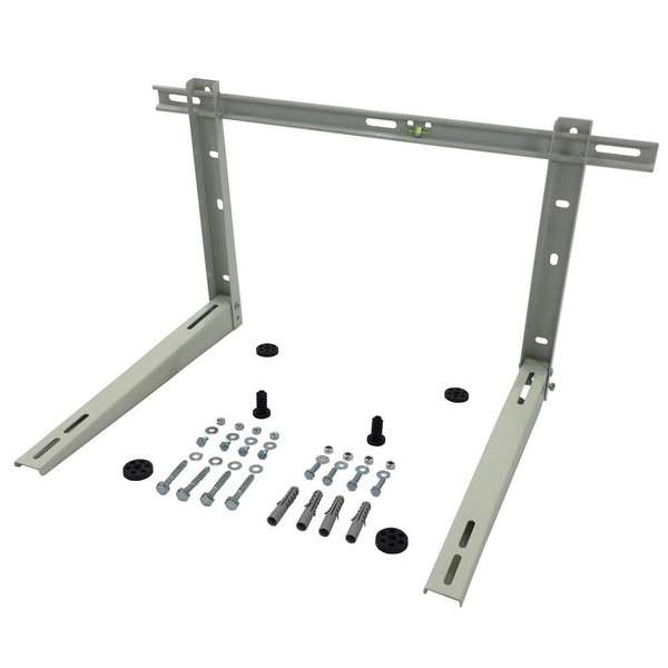

If you're hanging it from a wall, make sure you buy the better compressor brackets. The ones that flip down, and hang from a rail are much nicer than the shelf bracket type.
Can you post photos of the differences, or links to what you like to use? I hear a lot of bad things about flimsy wall brackets with poor finishes. Thanks.
I don't think there's an acme of mini-split hanger brackets, but these ones don't care about stud spacing and they work well enough. I buy the bigger bracket, no matter the unit sizing. It's easier to mount, and I can sit on them. Obviously, if your mini-split vendor has their own like this, then get that one, cause it's easier than ordering piecemeal.
This type ***** red hot rocks in hell. Period. No matter what the specs say, they're wiggly, jiggly, flimsy ****. $20 more material, and an hour's worth of effort on your part, and then they're marginal.
