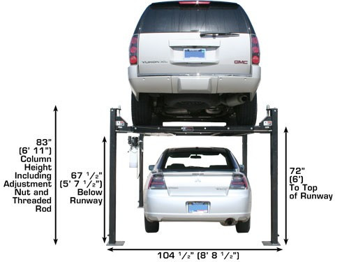

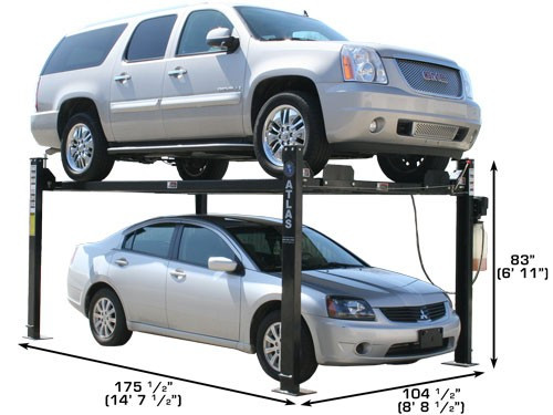

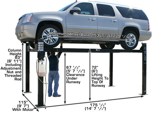

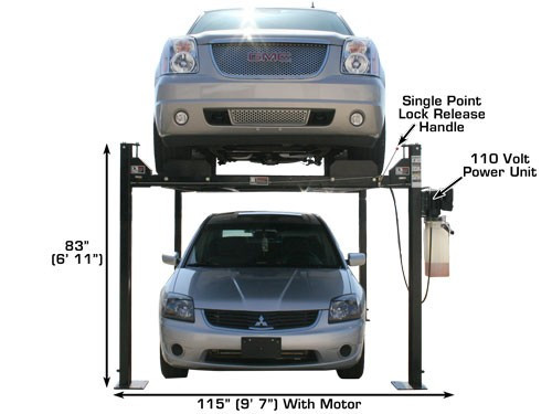

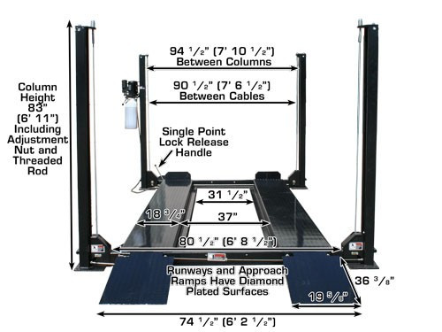

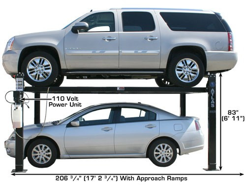

FYI, here are some pictures of the 8000 EXT lift I found online. They give good representation with dimensions, etc. Looks like the ramps detach that your drive upon, but you should verify. If they don't detach, you may have an issue with fitment.
http://www.atlasautoequipment.ca/atlas-garage-pro-8000-4-post-lift-8-000lbs-capacity/
