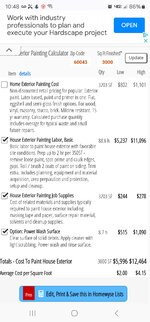

For that matter, most paint retailers will have a bulletin board with independent painters available. You can do the estimate yourself on Homewyse.com. I would pay my painters $25-$30/hr (Chicago suburbs) Painting the side of a barn is easy but you will need the right equipment. Sprayer, barriers, ladder or scaffold. business is slow so you can find them

I don't think you'll find a good professional painter with spray equipment, scaffolding etc for $25 - $30 per hour. At least I hope not.

Seems very cheap to me... I do all my own painting ( also have a nice airless and lift) if could find someone that cheap that did good work they could have at it...

Here's quote from your link 3000 sq ft in 60043 $6k - $12.5k labor, job supplies and power washing only. And this is priced for a home not a barn that may require additional equipment. This works out to $67 - $140 per hour based on indicated hours per Homewyse. Just saying....
