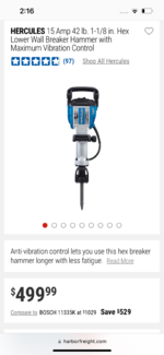

The Milwaukee you picture is for large diameter holes and chipping tile. The $269 Hercules is in the same category.
If you’re limiting yourself to SDS max tools you want something in the 23 pound range.
Another option is a Bosch 16-30 uses a 1-1/8” hex shank chisel. They are pretty much the industry standard of small demo hammers. Street price on a new one is about $1100.
This is Harbor Freights option.

23lbs is overkill for hole digging, nevermind a full size breaker. Sure it’ll dig into the clay quicker but pulling that big hammer back out gets old fast. Those are for breaking concrete, and only if needed.
The 14lb hammers do just fine for digging and they are far more maneuverable and pleasant to use. Keep in mind, you’ll spend a lot of time using these in a less-than-ergonomic position so a lighter weight tool goes a long way.
I dug these 2’x2’x2’ holes for footers w this Boschhammer by myself, took about 1-2hours a hole, and that’s through sticky limestone clay. Sometimes I had to dig through an existing footer, and that took longer. The nice thing about the clay spade is that it cuts the soil into large, intact slices which makes for easier removal by hand.
(Yes the footers are crooked, yes this brings me great shame long after they got covered by concrete)
I have to put fences up a few times a year and i dig out the 36”x12” holes for fence posts in 20 minutes or so, and the bulk of that time is for excavating the loose dirt. With two people, one on the hammer and one to remove the dirt, you’d cut that time in half.
Man it’s 4:30am and you’re making me want to dig some holes LOL. It is just that satisfying to do with these, though.
