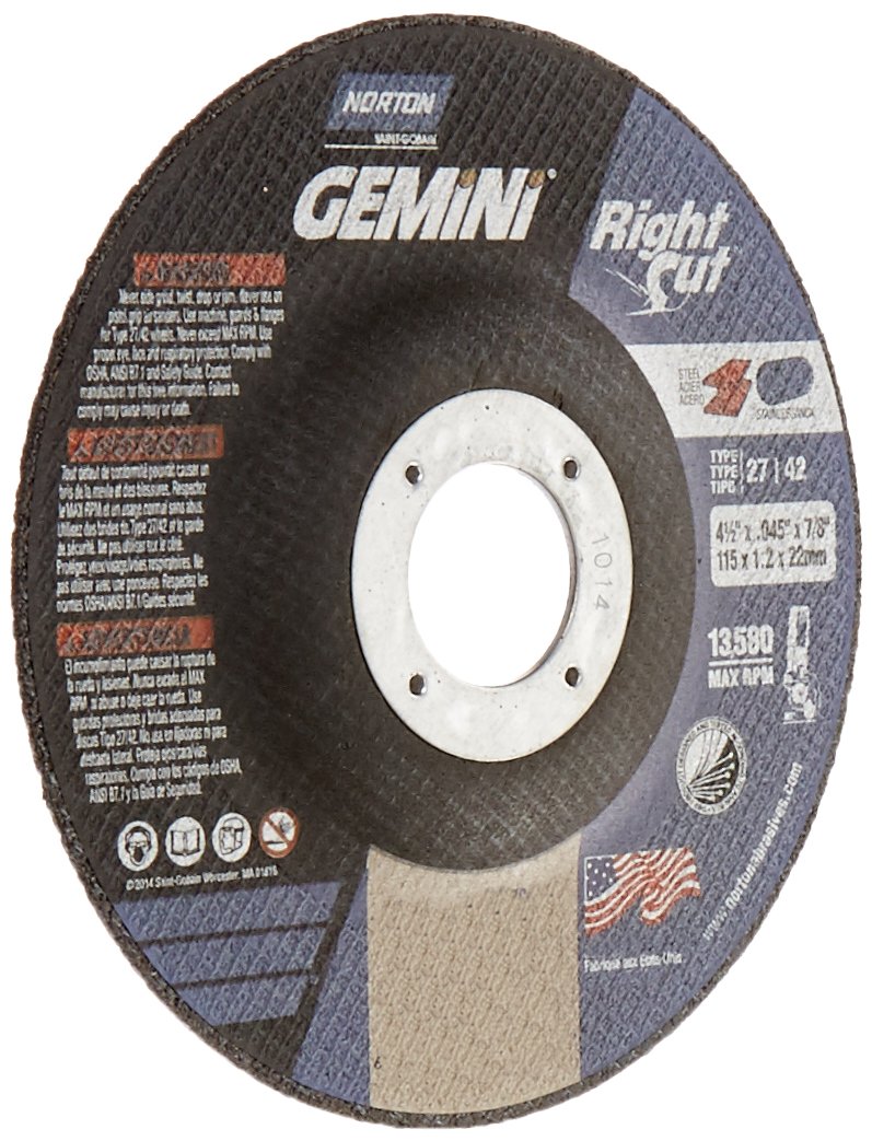

This is a Cutting Disc. This is used for cutting steel. Best thickness is 1/8".

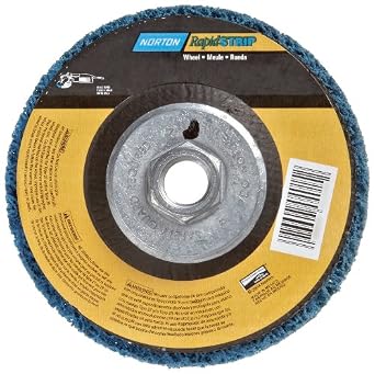

This is a Wire Wheel. This is used for removing paint,rust or other coatings on metal. These will shoot off the wires and are dangerous.
Finally these are Wire Cup Wheels. These are similar in use as above but are good for removing coatings on large pieces of flat steel.
One other mention is these paint stripping discs. They work wonders with removing paint from metal.

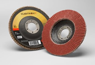

Get good flap discs. You'll use them more than anything. A couple death wheels (cut off wheels, usually 1/8") will last you a while.
Different wire wheels are good to have, from straight to knotted. The cups are much more efficient on a 7/9" grinder, but still good to have for a 4.5".
Whenever you see a good deal on quality flap discs, buy as many as you can afford. They are not cheap and if you start fabbing a lot, they are your best friend.

To reiterate a few good and bad points that have been said here:
_Seems you can afford and want nicer equipment so AVOID HF disc of all kinds. Period.
_Flap disc are superior in every way to standard grinding disc.
_If cutting material use .045" quality disc, anything thicker is wasted time/effort.

i use the thicker (.045 ?) 4 1/2" cutoff wheels, they do last a little longer than the thinner ones for me.

The thin Walter zip-cut cut-off discs are excellent, but expensive.I just bought a 10pk of the Dewalt ones, so I'll see how they compare.
