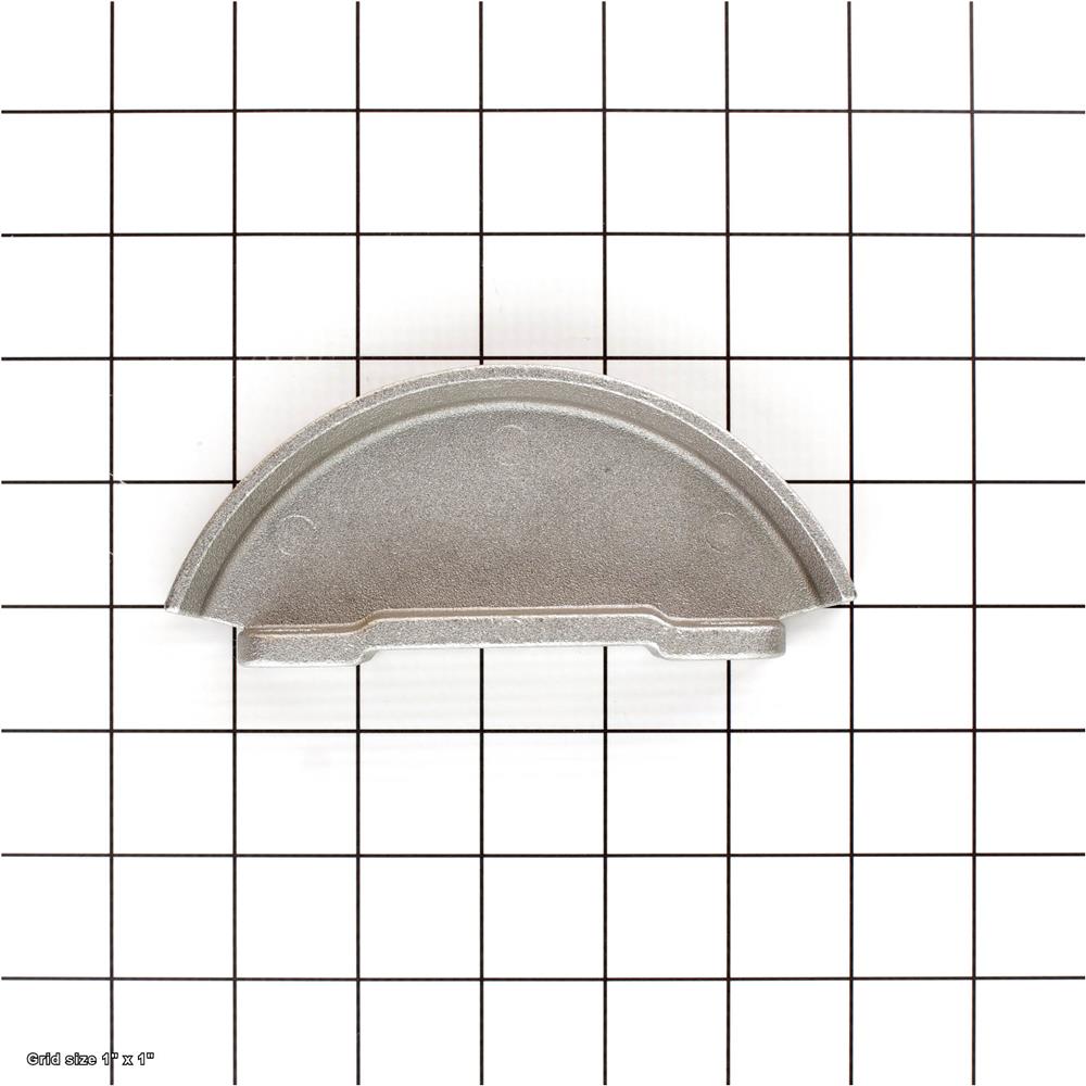

Which import belt and disk sander is this?
RichTes
Sep 18, 2013
54
The tilt in front of the disk needs to be fixed. No tags I see. Has the blue angle tag if that help
I’m sure there’s more than one equivalent model
Thanks
R
RichTes
Sep 18, 2013
54
Thanks. Probably the bracket. I don't want to use the wrong name till I look at the parts list. The wood holds it perfect 90 degrees.
Tomstir
Dec 29, 2014
70
