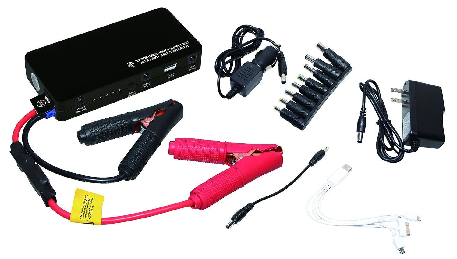

I want a jump pack that will start a generator, ATV, tractor and possible vehicles. Which option will give the longest shelf life of the battery and smallest self discharge rate. (ie most dependable for infrequent use)
1. Jump Pack using a traditional lead acid battery like this?
2. Or these ultra compact Li-Ion packs like this?
3. Current solution is a "hand me down" car battery and some jumper cables.

Lead acid batteries that are not on a float charger (regularly topped off), can expect to be junk if sitting for as little as 6 months on a shelf.

This. Guys will argue li-ion packs are a fire hazard, don't perform well in the cold, etc.......but the batteries in my Hobart Trek need some babysitting to stay happy while I've got Milwaukee M12 batteries that have sat around my house for over a year & still have full charge.

The problem with Li-Ion is there is a big difference in cell quality. Also slightly different chemistry can make a big difference in power and longevity.
I have no idea how you can tell what you are buying inside the jump pack.

have the tow truck folk gone to the small lithium ion battery packs?
According to other posts here on the forum about these, yes, some have as well as techs and junkyard guys. Those who like them report the convenience of the small size is hard to beat.

Isn't the Solar ES-5000 and JNC660 based on traditional lead acid technology?
And doesn't that mean these packs will need to be used often to avoid the short shelf life of seldom used lead acid batteries?

A note on maximising the life span of the lead-acid type. It was said they need to be used often, which isn't the case. They need to stay charged, and I'm guessing since most people would charge after use is where that came from.
Anyway, the professional units like the Clore products used to come with unregulated charging circuitry, so you couldn't leave it plugged in. Now, just about any box you buy will stop charging when it's at a certain voltage.

I tried lithium packs on diesel. Most of the time, it has not enough energy to start the engine. It goes flat or the wires get hot before the engine started.
This happens usually when the battery is really flat after forgetting to switch lights or the diesel is difficult to start.
Then I have to revert to the standard battery + thick jump cables.
