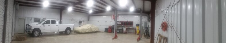

I have a 2-post Forward Lift, 10k capacity. I was settled on the Derek Weaver until I called a local installer. They sell and service, including warranty work, the Forward lifts. It was just under $4k installed. And they had them in stock back in early June. Took the installers about 4 hours.
