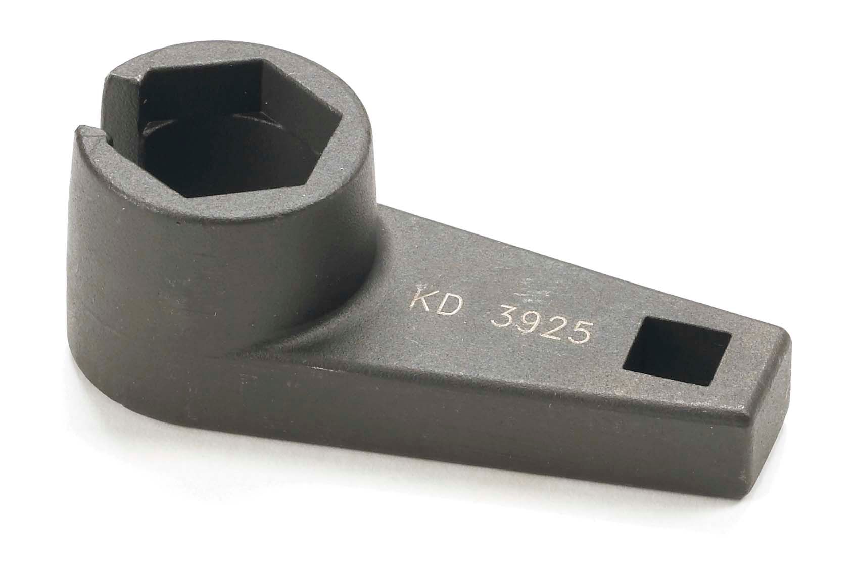

Which o2 sensor tool is better: deep socket with slit or crowfoot?

low profile crowfoot:
spin_prod_222882701
If I cut off the wires, will a regular deep impact socket fit over the o2 sensor or do I have to hack off the top part of the o2 sensor? But I still need the o2 sensor tool to torque it to spec.

To remove, always cut the wires so you can use a regular deep socket and put some good torque on it since they usually rust on.
To install, either one depending on access.

I have all three of those and I use the ofset one on the sensors thats on the manifold and the deep one seems to work better on the ones on the cat.

this is one case where buying Snap-On probably makes good sense, because this is an iffy tool in the first place, so I reach for a Snap-On version of the deep well with slit version as my go-to first choice.
The most important tip I can give you is to soak the sensor threads with Kroil - 24 hours before doing the job

If this is more than a one time job go with Snap-On or equivalent. I have a China made deep well, Pro Value I think, and it spreads. I had to put vise grips on it to keep it from spreading.

Why not just use a 22mm box-end wrench? :dunno:
(I mean if you are considering cutting the wires?)

a 22mm box is an excellent choice in theory, but all too often there is no room for a nice long one to swing, so you are forced to use some type of socket, and when reinstalling, often the connector will not pass through the box end.

Snap on do a kit which has all of the required 02 sensor tools in it, an extra deep socket with slit, normal depth and a number of crow foot setups. It's pretty cheap too. I've never had to use anything else other than that kit in 8 years of wrenching.
I've never seen anyone torque an 02 sensor to spec, just nip it tight and your done.

I have a deep slit O2 socket, but rarely use it unless I know for sure beforehand that the sensor will remove easily. In my experience the crowsfoot style are much stiffer, I've never had one of them spread and slip like I have with the deep slit socket style.
To answer your question, yes you can use a regular socket if you cut the wire on the old sensor. Please ignore previous advice about ignoring torque specs.

depends on the car some times only one style will work... best trick I learned was soak it in brake fluid first, if its rotted to hell and feels like its pulling the threads with it soak it again and run it back and forth.

i have best luck with socket (i prfer the 3/8 drive for access reasons)
some its better for crowsfoot (non shielded o2 sensors (lamda probe)

I have both, but I greatly prefer the deep socket with slit, assuming you can get a clear shot at it. You can also put a swivel joint on it if it's at a funny angle.
The "crowsfoot" style just feels very awkward and slips out very easily, at least in my experience. The only reason I can see for using that style is if it's in a really awkward angle and that's the only way to get access to it.
I did not need to cut the wires with either style.

I have the deep and the offset and each have their place. If you are using it for one particular vehicle just find out which one will fit. Where I work on many different makes/models is the reason for having more than one.
I also like to use a box end wrench when able to and just snake the plug through the box end. I have found this to be able to provide the most secure fixation on the hex.
I too recommend soaking prior to removal with either PB Blaster or Kroil. Had good success with both.

There is no "best".
You'll almost certainly need a different style for each car you work on. I especially like the sensors that you can clearly see, but not put any type of socket or wrench onto.

Get the one on the bottom. You will see why the one in the first picture is not ideal once you have done a few 02 swaps.

Cutting the wires and using a standard deep 6pt socket is best. Just make absolutely sure the replacement is the correct one before you waste your time and destroy the existing sensor. The issue with the ones that have cut-outs for the harness is they spread. Handy for installation, less so for removal. Not everyone has the luxury of a 24 hour penetration soak. Sometimes all the soaking and heat doesn't do a damn thing and the threads come out with the sensor which is always nice.

here is the exact socket that I have the best luck with on O2 sensors
buy1.snapon.com/catalog/item.asp?P65=&tool=all&item_ID=635717&group_ID=675562
How many cars does that size actually work on?
I usually cut the wires on mine... also not too worried if the replacement is the wrong one as I'll just reinstall the old and splice the wires back temporarily until I get the correct part. Easy as pie and your car will drive just fine like that for 100k miles if need be.

most cars, maybe 90%
especially on the business O2 sensors (pre-cat), as opposed to the tattletale O2 sensors (post-cat) that are there solely so that you can skip the old fashioned emissions testing stations!

I use a 22mm 12pt flare nut wrench. Works great on my car. The opening takes care of the wires and it fits on the exhaust manifold just perfect. My car is a GM 3800 engine.
The guy with the jag might want to try one of these as well as they are available in 17mm. PM me if you would like to buy one as I have these available.

Often, access is the determining factor. I've seen a number of cars where the deep style just won't fit; actually, it DOES fit, but the top end where the ratchet (or wrench) goes is now tight up against something. Hence I go for the crowfoot.
