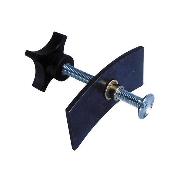

I tried the C clamps, channel locks and got tired of bulky tools around.. Now i use the simple light weight OEM tools pad spreader.. Cheap, lightweight, fast.. 10-15 dollars on amazon.. Now if youre doing big calipers, maybe get bigger stronger tools.. For average regular cars, trucks.. This works.
https://www.amazon.com/dp/B000CMHKRC/?tag=atomicindus08-20
