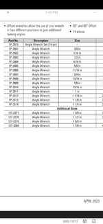

The CAT set 3/8" to 1-1/4" is around $430+tax public retail price.
The Tekton set, also USA made, runs from 1/4" to 1-1/4" and goes for $260+tax.
Despite the $100+ difference, I've still not decided which set I'm going to buy, but I've narrowed it down to those two. Hopefully going to order one or the other next week.
While the smaller sizes won't see much if any use, it's usually cheaper to buy a set and I hate buying individuals only to need a size I don't have.

If you go Cat price the two 7 piece set vs the 14 pc set. It saved me $30 to buy them separate.

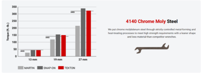

I can't comment one way or the other. But there are no shortage of "reliable sources" on the topic...
Directly from Tekton;
A 100+ year old manufacture;
YouTube forum favorite, Torque Test Channel;

For the same material, forging produces stronger products than machining, that is a very basic engineering fact.
Regular Tekton wrenches are surely forged too. If it made no difference, instead of forging the could make production a lot cheaper if they just used a roll of sheet metal and stamped them out.
