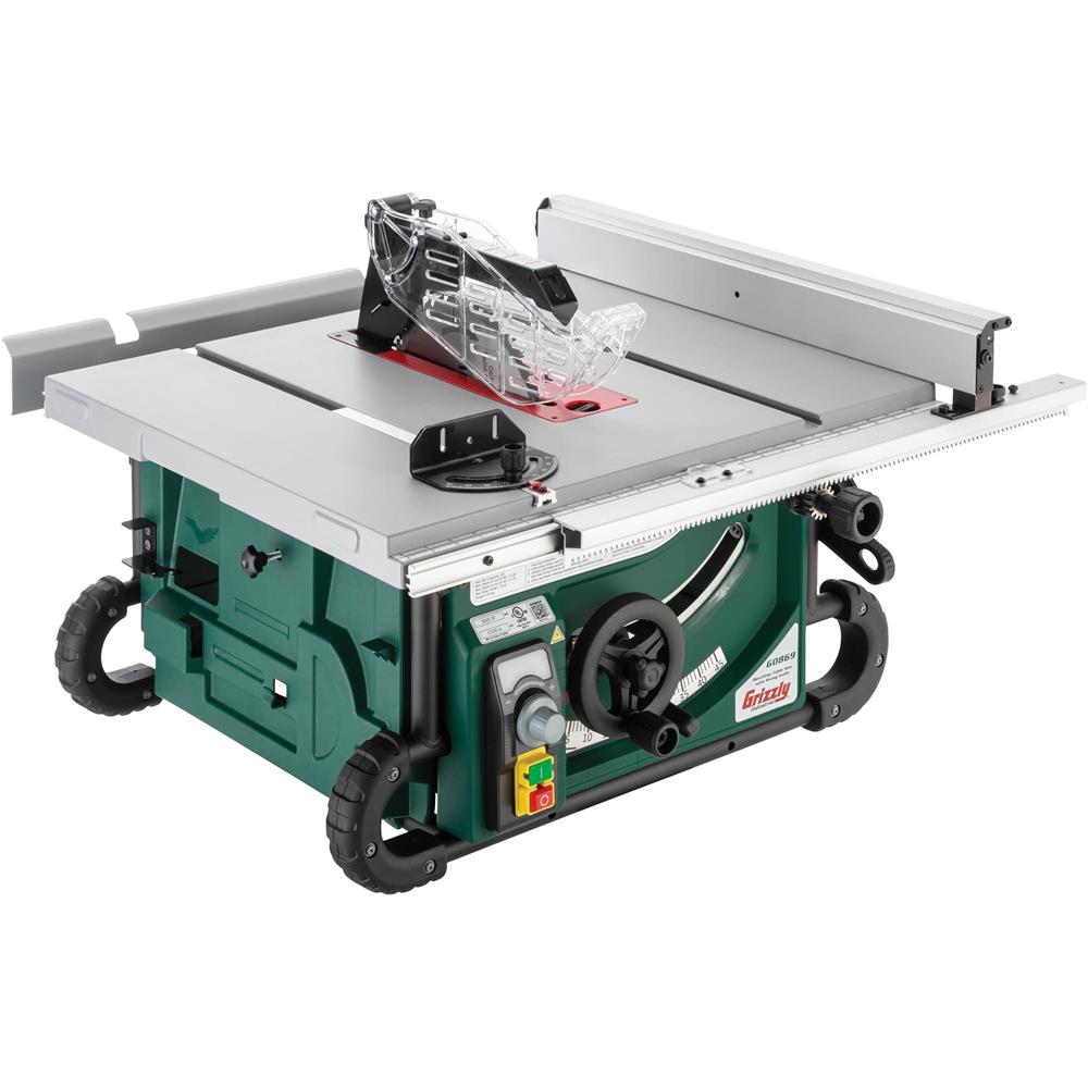

I know OP is all sorted out now but....
Has anyone used one of these Grizzly benchtop saws? Would love some feedback on it. 10" blade, rack and pinion fence, 13/16" dado capability, adjustable blade speed (?), allegedly 2hp...
I'm also trying to keep things compact and mobile (would likely build a small rolling table for outfeed support) but also be able to do some woodworking on it, until I have the money and space for something bigger and more powerful. I currently have a Craftsman "Motorized" saw with aluminum top and crappy fence, and it's pretty under-powered versus hardwoods.
