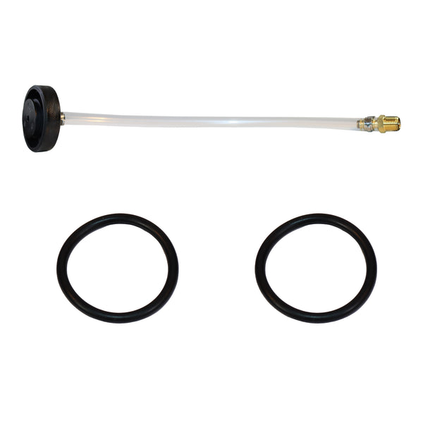

Which toyota adapter for this brake bleeder?
Bennylava
Apr 17, 2012
955
Cleburne, TX
So I got this OMT brake bleeder off amazon and of course the recommended 42mm adapter doesn't fit the brake reservoir. It's screw on, and the 2018 camry hybrid has that other thing they call "twist" or push lock. It functions similar to how a radiator cap does.
I think I might be able to use something like this, but I thought it best to ask all you veterans first:

I bought the same bleeder, but in the version that is supposed to come with the Toyota/Lexus adapter. It was the same as yours. I bought a kit that had caps that fit my Vanagon and '93 Corolla.

I bought a pressure bleeder similar to yours from amazon a while back and it came with 5 or so adapters and I couldn't get it to work on a ford. Ended up order this and so far it's been great. Haven't used the toyota adapter yet so can't say for sure but it has a bunch of adapters and seems well built.

I have a Mityvac pressure bleeder that works pretty well and includes the Toyota adapter. BUT, I have found I really prefer vacuum bleeding for routine fluid replacement. I use an 8-quart oil extractor. The pressure bleeder still works for stubborn caliper replacements and that sort of thing, but I probably don't even use it once a month now.

In case anyone searches in the future, the Mityvac one worked great. No issues, and didn't have to buy an adapter that costs more than the tool.
All I did was follow all instructions on that Car Care Nut brake bleed instruction video.
