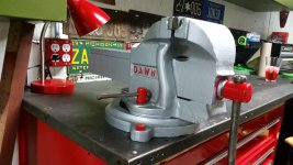

Well, here she is all painted up! Im not head over heels with the way the color turned out, but i do love having it cleaned up and ready to roll...

Good job, I like how it matches the rest of your shop, even your drink. :lol_hitti You might regret painting those sliding surfaces though.

You really need to mount a vise like that to something more substantial. Kind of like putting racing tires on a Chevette. Can't get near the potential of what that can do when what it is attached to would fly across the garage doing what a vise that size is made to do. Maybe a smaller vise that takes up less space would be more ideal.

thanks for the feedback! I'll be (soonish) welding up a "bottom" for the benches and once that's done, they're getting bolted to wall studs. I thought about the paint on the slide and the base where it rotates - but since I know I won't use it that much I wasn't worried. Although i'd love to be in the garage doing more, the truth is i'm 28 years old and have a 5 month old - so my free time's pretty limited between work and usual house/family stuff. I think for now this beast will be a bit more of a decoration/conversation piece than the workhorse it should be.
