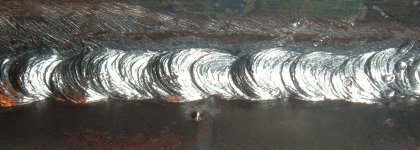

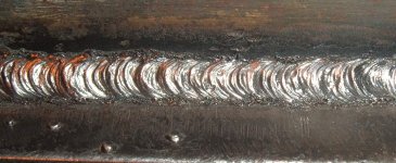

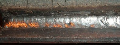

As I mention the Forney, it is a 3/32 6011 machine. Anything else trips the breaker. A good one like the max will output 1/3 more 100%.
Hrere is a test and I doubt I was very sharp. pic one, machine struggles to make 75 at best and tripped half way thru with a 1/8 6011, pic 2, 3/32 6011 and can weld with that but its too dam small and fussy but it finished the rod. Pic 3 is 3/32 7018 DC rod and 4 is AC. Both barely made 75 if that and tripped.
6013 is mild penetration but has near the same current demands as 7018 to run correctly. The machine that made these needed another 10A minimum, just didn't have it.
