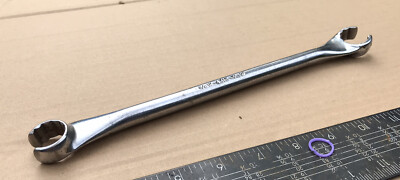

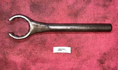

The tools you really need for BSP hydraulic systems are Whitworth flare nut wtenches, and they are slightly more rare. The best were made by Britool, and Blue Point (pre Snap On), but the only option is used!
Edit - The Britool look like this
And the Blue Point like this

Some Blue Point Whitworth Line wrenches. maybe missing a few, never seen a list.
