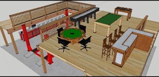

Who put one in, has it been handy and what size is it. I'm looking at 20' square thinking at 8' high it's just high enough to put stuff up there on pallets using my skid steer. And I can walk underneath.

For those of you who have these nice lofts in their garage, what's the side wall height of the building? I'd love a mancave when I finally have the opportunity to build mine.
My ceiling is about 15' 4" with 2×10 joist this yielded me around 7' 2" ceiling height both upstais and down

I added one to mine. My building is 40x64, and I only came out 11' from the wall, and my floor joists overhang 1', so total mezzanine is 40x12. I built a small kitchenette/bathroom underneath the first 24' of the mezz, and the last 16' is open area for storage.
My ceiling is 16', my walls for the mezz were standard 8', so using 2x10's for joists, and 3/4" T&G flooring, I have just under 7' of height on the mezz, which is perfect. I plan to add some shelving units from Menards soon to organize things, but that additional storage is awesome!
I need to add a railing, but otherwise the mezzanine is fully functional!
