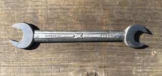

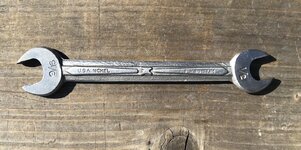

Hey guys little help trying to find out who made this wrench and what year.. I was at my local pawn shop getting misc. Sockets ,wrenches to complete my emergency tool bag,for my truck , when I found this beautiful nickel steel wrench It has an "X" center on both sides
5/8 11/16 USA NICKEL X MOLYBDENUM. On one side the other
PATENT NO. X. 97825. I've attached couple pics. It's a great looking wrench, couldn't find any more just this one.. thanks..

I stole into this thread while starting one of my own on the same general topic......Wondering who made this little stubby......Any suggestions?Nickel1.jpgNickel3.jpgNickel4.jpg
16,585
Yep, for sure Bridgeport. I’ve had several. Here is a prewar example followed by one made after the WW2 metal restrictions went into effect.

Pretty sure it was also Bridgeport. I have one somewhere around here. They LOVED that composition.
Upon further contemplation, I seem to remember having some other wrenches of theirs that employ the "sloped beam" to effect an offset with only one bend at each end.

I agree with Bridgeport Hardware. I have a small set of the DBE's which are really handy. Once I learned from AA that NiMo was Bridgeport I surmised that similar looking wrenches with the fatbob font "Alloy Steel" or USA were also BHM even though not marked LiMo.
