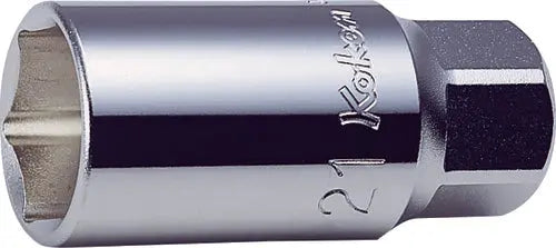

Similar to sparkplug sockets, but with no skips. Astro (and a whole host of other companies) make nano stubby sockets that have either a 17mm or 19mm external hex drive which is excellent, but I want a deep version - makes for tightening recessed strut nuts a cinch that also require a counterhold. This allows me to use one normal torque adapter across a myriad of sizes. Offset torque adapters might not fit everywhere, hence my apprehension in investing lots of dollars in them.

" tightening recessed strut nuts "
I've never seen what you are asking for but for the application you mention a pass through set may be the ticket. Works for me.
Most pass through sets have proprietary spline drives and I can't say I've seen deep versions, I want to be able to tighten with a normal torque adapter and torque wrench:
Basically a full size range of these:

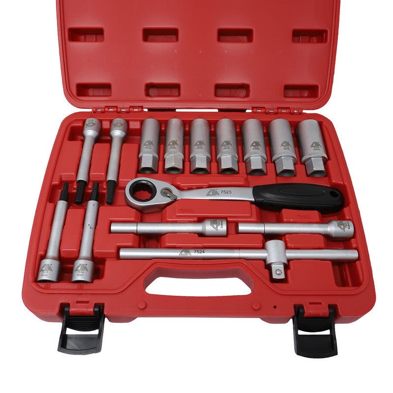

My google-fu wasn't good enough, but found a set by CTA. Anyone else?

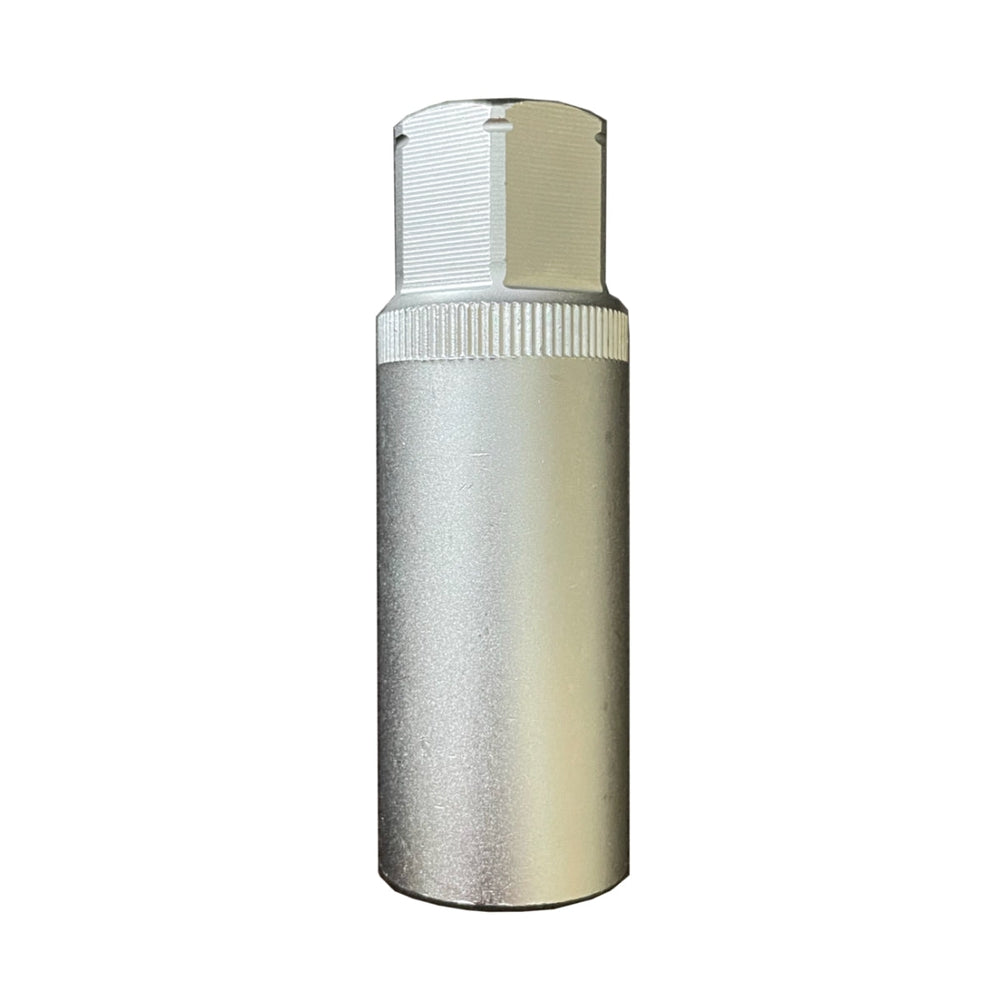

You could buy a cheap set of 1/2 deep sockets and grind wrench flats into them. Crows foot and torque wrench on the flats and drop a hex through the anvil hole.
Whole heck of a lot cheaper than $300+ for tools that see infrequent use.
