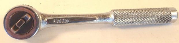

So... if these are indeed Easco made, what would be an appropriate period-correct ratchet? Something along the line of the Easco 71-1106 ??
Would an Easco made NAPA have that raised panel on the shank?

I have seen them with and without the raised panel. I don't know any specifics, however. Here are some pics I found.
Idk on the Napa ratchet either.
The spinner matches Easco.
As far as your black spinner, that version is common to the Easco and Master Mechanic brand sets,with the different style round head ratchet that had either a black handle or all metal what some refer to as paint brush handle.
