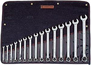

Well, don't know if they're sure grip but here they are:
Flivver250
Nov 11, 2013
797
Florida/Dubai
For the money Wright is hard to beat IMHO. If money is no object, Snap-On quality and accessability to warrantee is good, but they are 3 or 4X the price of Wright. My last few tool purchases have been Wright and I am very happy and I have 100% faith in their ability to perform.

I have some Wright Sure Grip and Wright non sure grip. Sometimes I need to use the non sure grip on old beat up fasterners, because the tolerances of the sure grip are so precise and tight and "grippy".
It does feel reassuring to use Made In USA Wright wrenches on big fasteners. I've had a couple Hecho in Hino wrenches break... not fun.
Where does one buy Wright tools? :dunno:
I've used SO wrenches at work, they're great but not worth the price tag (IMO). I've got it narrowed down to a Wright, SK, Williams (US), or KTC set. Leaning towards Wright because they come with a pouch lol, less that I'll have to shadow in my box.
