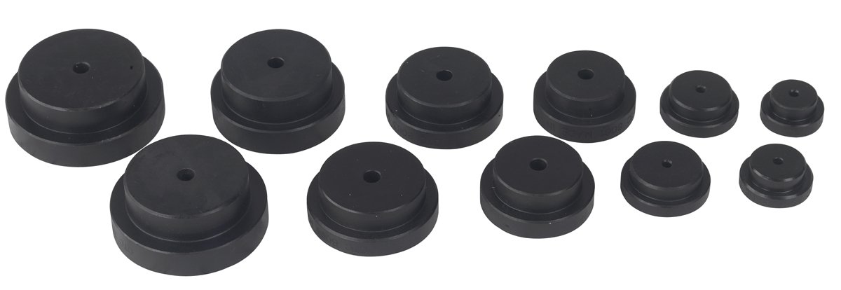

You want overpriced in appearance, check out step plates, but my goodness, I use those suckers all the time and boy are they worth it. I have never regretted any puller, nor thought them expensive after the first use or two. Now cheap pullers... Well do not judge the usefullness of pullers by harbor fright's offerings. I will leave it at that. One brand you did not mention in your list of good ones is proto, they make an excellent system and have for a very long time. Also posi-lock, the ones that have a system with which to tighten the jaws on the object being pulled are worth their cost.
Did some looking. Are you talking about step plate adapters for pullers?

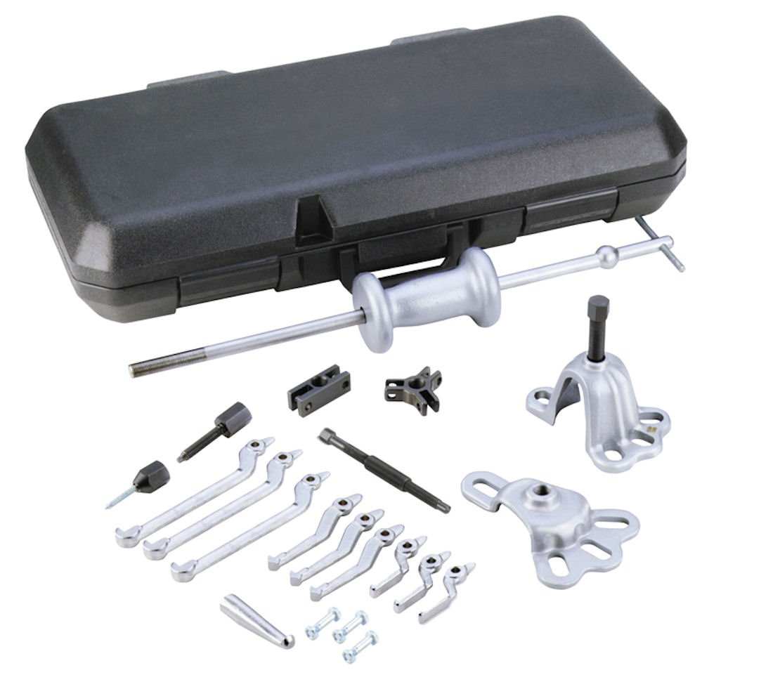

Step plates are very strong and used in many puller operations. When you need one you need the right one.
I have some of these but not this whole set. At $115 on Amazon that is a steal.
Heat treating is important but I think a lot of the cost is forging. Bigger pullers cost more. I'm a fan of OTC. Currant stuff may not be quit as good as the older Owatonna but it is good.
This is a good general purpose kit and a good place to start but don't expect to stop here. As special operations come up you will need more pullers.
That is the OTC 10 way set (7948)
If you start off with OTC you will not regret it. They are very high quality in today's market. They make all varieties of pullers you may need and staying with one brand means that more of the parts will interchange from set to set.
Snap On stuff is better but you pay for the name. You are also paying for a bigger and stronger tool but it's not really needed most times except by pros.
Once you have the 10 way kit when you need the axle bearing pullers you won't have to buy another sliding bar. There's just the puller ends sold. Doesn't always work this way tho. When I needed a 10 lb weight for my bar I couldn't buy just the weight, I had to get another bar. If you start off by getting different brands their parts won't interchange.
BTW, for old pullers I like Old Forge. They are still around I think but don't make as many things anymore.
