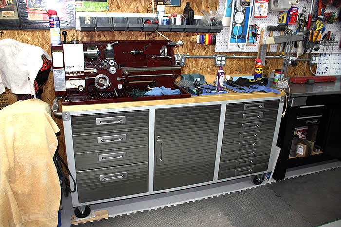

Because it's a cool tool and you can do whatever. Between my mill/drill and the lathes I can fix a lot of stuff. Yes, a $2500 tool to fix a $2.50 parts is nuts, well - so what LOL.
This little guy has paid for it's self about 4 times already. I use it to modify -AN fittings to work on C4 Ford transmissions. Thanks to the Internet, while I won't be retiring anytime soon the operation makes a few bucks and I have parts all over the planet.
The 12x36 hasn't really found a big use yet, but it will I'm sure.
A welder is a handy thing too - the stand is home made
