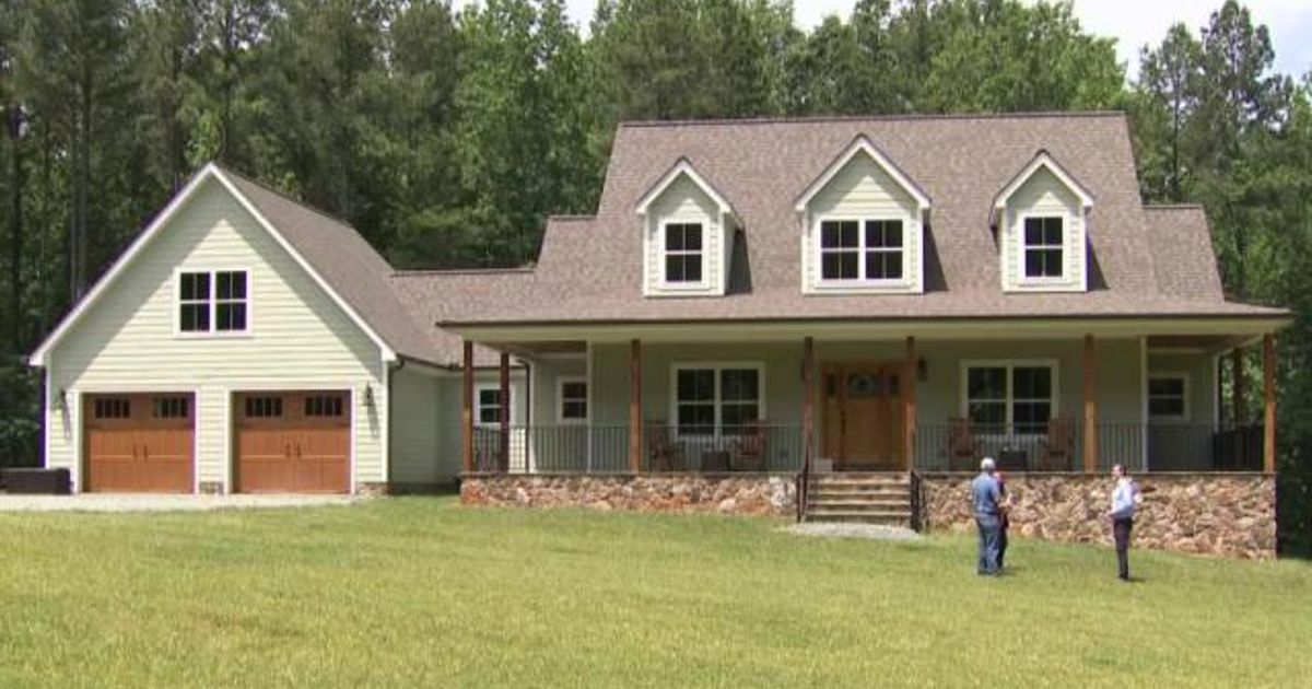

I'm wondering what prompted the homeowners to hire their own independent engineers to look at it in the first place.

public entities are generally immune from liability. so whether the inspector caught stuff or didn't catch stuff has no practical consequence. Designers (architect, engineer, etc.) have a responsibility to prepare plans, drawings, and specifications in accordance with the building code. Contractors have a responsbility to construct in accordance with the building code. Problems in construction generally lie with one of those two groups. I have never seen it lie with a building inspector regardless of how incompetent they are. And if you DIY, you are generally taking on components of both designer and contractor.
If you read the article, the suit against the county got tossed (due to the immunity thing) and the contractor who screwed up the construction is on the hook. get mad at the county all they want, but the contractor who put it together wrong is rightfully who is at fault.
Really, I should tell that to the family that filed suit against us for tripping over a curb in the parking lot, or the guy that took a swan dive off the second floor, or the very over weight woman who had her shoe bust and go rolling down the stairs, or.....................

FWIW I don't know how you expect to inspect your way to compliance at the residential level. I really don't. It's not really a practical undertaking. If "dozens of code violations" existed in a single building, I would expect the inspector to miss a lot of them. That's just reality.
The story explains why they hired somebody to critique the house: "Once the family moved in they noticed barely anything was put together correctly-in fact, it’s so bad multiple experts, fear the house will collapse"
