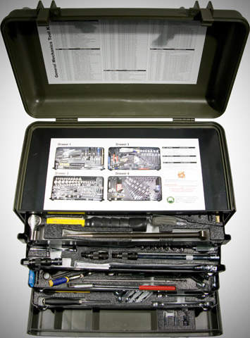

To me it would depend on end use, how durable apossed to being organized. The Army switched over to plastic Kipper tool boxes. Drawers with foam for each piece.
http://www.offshore-technology.com/...-equipment/kippertool/attachment/kippertool1/
They ended up being almost a heavy as metal boxes holding same tools and much larger. If they were abused they became useless quickly.
The only advantages were to inventory you knew immediately your 10mm was missing and the had a handle and wheels like luggage. Wheels only worked well on shop floor, asphalt in motorpool was too rough. Had to slow down or it would flip and something would scuff or break.
I wouldn't go with plastic unless its going live in a corner and be taken out to hang picture or fix a faucet. Metal boxes can ding and rust but can sanded, hammered, welded and repainted. da667ee6475ff3713eeb1581519bd697.jpg
