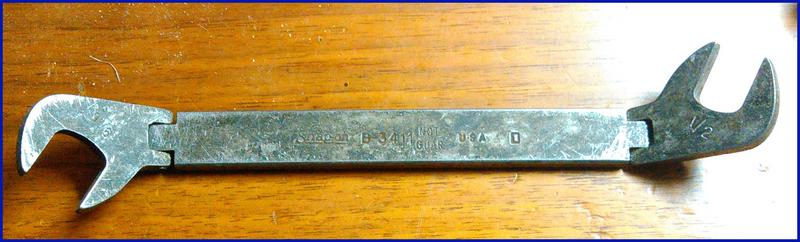

My Snap-On wrench with pivoting heads is labeled not guar.
That's pretty cool with the hinged ends, were there sets of those, or were they made for a specific machine purpose?

B3411
I use to think these were refrigeration wrenches. But I found one in an industrial cat from 63. They were made primarily for orifices on gas ranges. just this one model. they are quite hard to find.
