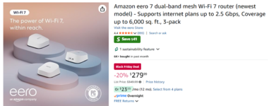

We've been having some connectivity issues on our Spectrum network. Roku devices buffering, etc. And, it seemed to affect the hard-wired PC as well.
Spectrum was out twice today. Replaced modem & router and replaced cable ends at the demarc from the pole cable and the feed to the modem. Everything looked good but, later, issues again. Called and they scheduled another tech to come back this evening. I will say that Spectrum was really on top of it. I called originally at 12:00pm and the tech showed up at 1:15pm. Second call was at 3:00pm and tech showed up at 6:00pm.
Second tech replaced modem and router - different/newer router this time - and added a splitter inline to bring down the signal. Said they've seen issues with the downstream signal level being too high.
Anyway, we were still having some issues so we disconnected almost everything from the router and I'll be adding them back one by one to see if I have a problem cable. I'll probably run most/all the hard-wired stuff through my unmanaged NetGear switch instead of using the router ports for certain devices. Right now, with some devices disconnected, it seems OK... so far.
The cable guy suggested looking into mesh wifi extenders - something I have considered in the past. I know 5g has more issues with signal strength/penetration. Our house is 2-story, about 2700 sqft. I'm thinking 3 devices - 1 at the modem, 1 centralized downstairs, and 1 centralized upstairs.
Two questions....

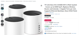

  1. TP-Link or eero? TP-Link I'm looking at is wifi-6 and reasonably priced. eero is more expensive but more future proofed (WiFi 7). I'm OK with that if it's a better system. The TP-Link wifi-7 I've seen is WAY expensive.
  2. It sounds like the device at the modem can replace the Spectrum supplied router. Is that correct? Or, is there any advantage/disadvantage to just plugging it into one port of the Spectrum router and going that route?
I'm a software guy so I'm kind of out of my comfort zone here. When I had IT department management responsibilities in the past, I was fortunate, and smart enough, to hire sharp network guys to deal with the plumbing.
Any help would be greatly appreciated. Our needs are not exhaustive. 4 wifi Roku devices/TV's, hard-wired PC, printer, NVR, alarm panel, laptop either wifi or, typically, hard-wired. Thanks!

TP-Link has been under a lot of scrutiny for security issues related to ties to the Chinese government. I’ll leave my opinions out of it and let you look into that on your own.

Never had a problem with TP link. I'd trust thst brand over any of the cheap brands or less common ones.

Going to pull the trigger on the eero wifi-7 3-pack.
As @wyliesdiesels mentioned, they'll do dynamic channel selection on each band to pick the least congested available. I did check and you can't override that. It's dual band so no 6Ghz but I don't see that as anything I need to worry about.
Going to knock $10 off my Spectrum bill every month!
Thanks to all for your input. Much appreciated. Fingers crossed....
