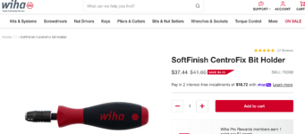

The Wiha 76000 gets a lot of good reviews at Amazon about holding bits tighter than most. But I have seen 2 reviews (out of 200) complaining that the the metal bit holder is tilted (not on the same axis as the handle). I still ordered one at Amazon, for $30.45

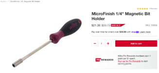

For oily conditions Wiha offers "MicroFinish" handles on some of their tools. I recently bought the made-in-Germany 125mm Wiha bit holder shown below, and I would rate its magnet strength to be identical to that in my Felo and PB Swiss bit holders.
I have two of those and they're awesome. Holds bits TIGHT. Obviously, no risk buying on Amazon with free returns. The reality is that they sold probably 10K of those without any issues and those people didn't post reviews saying "it's great", but when there's a problem those buyers always make it known. This is fine, but you need to adjust the percent "bad" for the other 95% that don't post reviews when the item is fine.
Edit: I also have the non micro-finish bit holder in your other post. I like it, but with they also made a shorter version.

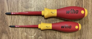

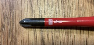

ecotec
Oct 5, 2010
5,509
Must have these:
Insulated screw drivers
Look closely at the tip- the insulation is flush with the tip:
The good is that are so much better than the standard version. The insulation is way too thick on the standard version.
The bad is that the slotted are not sized for SAE screw heads. They are sized for metric screw heads. The vast vast vast majority of hardware in American electrical products is in SAE.
The Phillips are fine for electrical work.

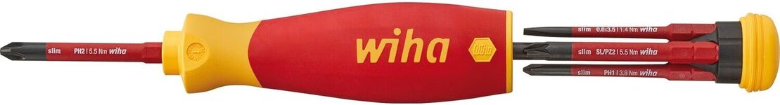

i84x
Nov 1, 2024
126
Earth
Slim blade VDE screwdriver set they are the best insulated drivers I've used and the pocket max 4 in one VDE driver if you just want a small insulated driver to keep about just in case.

Dave455
Mar 19, 2013
5,863
Sussex, England
Yes, that's precisely my point- they moved some operations to Asia, and to Poland, and then overnite, everything they make is garbage to some here. There's a vocal minority here that blindly equates COO with quality, no matter the actual quality of what's produced. If you stamped "Swiss Made" on a high-quality Chinese widget, it'd be the greatest; stamp China on it and it's junk.
The strange thing is that I've never seen any complaints here about the Milwaukee cordless tools made in Vietnam- they're evidently great, as they should be. So, the Vietnamese can make complex cordless tools with the right materials and equipment, but somehow can't make an identical quality screwdriver or bit as a German can -if you give them the same equipment and material used in Germany? Yeah, I get it, I'd rather pay a few dollars more and have it all made in Germany, but that doesn't make it junk if it's made somewhere else.
Wiha owns the Vietnam factory- they control it. They can ship them the same equipment and the exact same steel. If someone in Vietnam can perfectly sew $$$ designer clothing, I'm guessing they can make an $8 screwdriver that has essentially all of the machining and forming done automatically- it's load the stuff in the machine and hit the "start" button; we're not talking about making a Rolex watch. The Vietnam made Wiha bits were one of the best in the Project Farm test- the main issue was, ironically, that they were too expensive. I have quite a few of the Wiha Vietnam made bits and have no issues with them.
It sounds as though the current Vietnam made Wiha bits are of reasonable quality.
But it was not always thus. I was a regular buyer of Wiha bits back when they changed, and the first bits I received from Vietnam were not the same quality as the German ones.
One of the slotted bits had a bent shank, and the finishing of the tip was not comparable. I didn’t even notice the change in COO at first, but finding an inferior product I looked closer and was unsurprised.
At the very least, the quality control was lacking.
Must have these:
These are very good. Maybe one of Wiha’s better products at present.
Obviously, the slim tip allows you to access recessed screws, but that’s not the whole story.
The flush insulation means there is nothing to catch. With many insulated blades, even if the insulation does fit into a recess, it’s easy to catch it and tear it. These don’t suffer that way.
The insulation is also much harder and more durable than on many drivers. The insulation to tip fit, is very good indeed.
Incidentally, in much of Europe, and certainly the U.K, these insulated drivers are not for “live line” working, as is sometimes assumed.
The main reason for their use is to provide extra protection in the event that an incorrectly isolated circuit is encountered.
