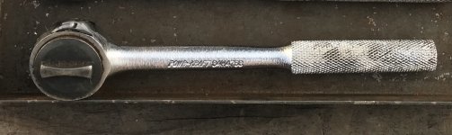

Late to the party as usual, but here's a sad little Wilde item.
I picked this up at a Restore today; couldn't believe my good fortune. Oddly, the ratchet had a Wilde swivel adapter GLUED onto it.
I took it home and pried off the swivel, and what do I find but a missing detent ball.:mad:
Too bad; the ratchet is in beautiful shape otherwise.
Now I'm wondering if there's another brand 1/4" ratchet out there made by the same folks who made this one for Wilde - with the same mechanism, so I can cannibalize it.
Does anyone have an idea to save this piece from uselessness?

If I remember right, Wright made these.

Agree. Looks like either wright or Thorsen made. Another thought to try tho...how snug does a .177 BB fit? Can find a heavy little spring and BB or ball bearing at good hardeare store and try to press it in there. Doesn't appear to have any quick release mechanism to worry about. Might have to use just the right sized punch and stake it in after you find the closes ball and spring you can to secure it a bit too. Ive made this work mote than a few times.

If you are unable to re-Install a ball and spring and can’t find a matching Wright or Thorsen ratchet, you might compare a Powr-Kraft 1/4” drive ratchet. They were supplied by both Wright and Thorsen. The Wright supplied ratchets have a W in the part number and the Thorsen made ratchets have an H in the part number.

Many thanks for your advice and help, folks.
I'm part-way there - I found a junk 1/4" spinner, which, after a little Dremel persuasion, donated a spring and ball that fit perfectly.
Now I just need to figure out how to hold the ball down and make a punch mark or two next to it.
...wish I could see the tool that does this operation in the factory.:unsure:

Ive used a regular pin punch that is just slightly larger than the hole. Put the other side of the 3/8 square drive on an anvil or heavy steel and whack er!
Oh yeah, make sure you have the spring you want in there before doing this! After its staked, its hard to get back out

Thanks - sounds like the right idea. I'll try it.

Well, Zrxrunner, your method worked! Thanks! I didn't hit it quite on center, and I hit it a little too hard, so that the ball doesn't stick out as far as I'd like. But it does hold the socket well enough, and it doesn't look too bad.
All in all, a success.
