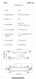

I just got my Bendpak HDS-14LSX installed this week, and now I’m looking to “complete” this piece of equipment with a way to lift all 4 tires off the ground. The offerings from Bendpak including the RJ7Ws for $2,000 a piece are unfortunately far more expensive than I can justify.
I found Amgo’s J6H jacks available at a far more attractive price. My question is, will they work with my lift? Has anyone put an Amgo rolling bridge jack (or I guess any Amgo rail rolling accessories) on a Bendpak lift?
I looked at the specs and measurements available on Amgo’s website and compared them to information on Bendpak’s RJ7W and measurements I took on my lift. I believe they should work.
MY TAKEAWAYS:
My accessory rails are 87cm apart at min width and 123cm apart with the ramps pushed out to max width. The Amgo J6H shows 812-1302mm for wheel spacing 👍🏻
The top of the accessory rail to the top of my runways is about 14cm. Amgo shows the wheel to the top of the arm (no lift pad) as 173mm, so that should put the arms at ~33mm / 1.3in. drive over clearance without pads and ~68mm / 2.7in. with pads. (Bendpak’s RJ7W is 102mm / 4in. with pads.) 👍🏻
The 840-1357mm arm reach looks sufficient. (Bendpak’s RJ7W shows 1062-1426mm, but that’s outside edge of the pad, while Amgo is center of pad.) 👍🏻
The lift stroke is 230mm / 9.3in. (Bendpak’s RJ7W is 273.2mm / 10.76in.) Should be sufficient, right? 🤷‍♂️
I’m good with manual pump vs. air (I might actually prefer it to be honest) 👍🏻
Wheels profiles look similar, but I guess this is really the only place I could go wrong 🤷‍♂️
Anything I’m missing?
I’m hoping someone has already done this 😂

Today the two Amgo J6H Rolling bridge jacks I ordered arrived. I can now confirm they work with my Bendpak HDS-14LSX lift. Drive over clearance is about 1” with arms fully retracted and no pads installed, so it should accommodate just about anything.
The only potential downside I see is that because these jacks tuck so low in between my rails, some of the jack’s stroke is used up before I can extend the arms over my runways. This leaves me with ~6.5” of stroke from where I can extend the arms to the highest lock.
All in all I’m quite happy with my purchase. If you are interested in using these jacks, I’d recommend measuring your rail & runway heights and comparing them to the Amgo’s drawings / dimensions I that posted. I can only speak to my experience using them on my HDS-14LSX.

If you need a bit more height is changing out the wheels to a larger diameter out of the question?
lg
Not a bad idea. I would also have to add some metal under the side “tabs” as when it is loaded, the wheel springs compress and it rests on the solid “tabs”.
So far I’ve been able to get the wheels off the ground on the 3 vehicles I’ve had on it, I just have to be a little choosey with which pad extensions I use.

Is it really 251 lbs?
My arms, legs, and back felt like that seemed about right 😅
The label on the jacks says 238 lbs gross weight. Maybe that’s without the lift pads and set of extensions? Either way, somewhere in that neighborhood for sure.
