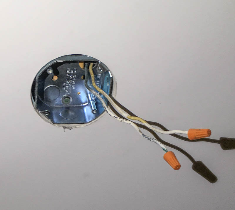

I'm replacing a light with a 20-30lb ceiling fan. I expected to have to replace the junction box, but it's metal and appears to have been reinforced previously. It's an old bracket, but maybe someone has seen something like it before?
I gave it a good push and pull and it's not budging. For me to remove it, I would have to crawl around my attic and throw sparks with a die-grinder or muck up my ceiling. I'm hoping to avoid that.
The junction box has two threaded tabs that seem solid. Am I asking for trouble here or is this a good (albeit old) mount for a fan?

No, it needs to be a fan rated box.
Edit: the photo shows a old style box support, and a standard 4-0 ceiling box, see above.

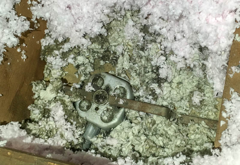

If it was me, I think I would just add some blocking and then a couple of screws up through the box.... but then again, I am not an electrician :)

That was a common box/hanger around me w/plaster ceilings ... it's going to be able to hold a fan. The issue with fans is the screws going into the box that hold the fan --- that's the connection to worry about.
I never wanted to mess up the ceiling -- if you drill out the screw hole and go through the back you can slide a bolt through each and you have made a fan box. Some blocking is most likely overkill ..but easy to do.
You should be able to remove the box from the center support and use it to place a fan rated box back. Add blocking.
I try and do as little as possible around plaster -- trying to remove the old brace is not possible w/o damage. Especially with a saw

On this type of box I have cut the two supports right at the joist, using an end-cutting metal blade on a Dremel oscillating tool. Then I just installed a modern fan box between the joist.
If you do decide to cut that support bracket near the plaster, you need to watch out for vibration from the oscillating tool. You want to hold the bracket with pliers, and then use the tool with minimum pressure to cut the metal. If you let the oscillating tool push the bracket from side to side or up and down too much, it may vibrate enough to crack the plaster coat underneath. Plaster finishes are not flexible, so they crack instead of flexing.

Yes. Those threaded tabs are the weak link. In addition, they have just a few threads. Compare a fan rated box to those and you'll see many more threads available for the bolts and much beefier construction.

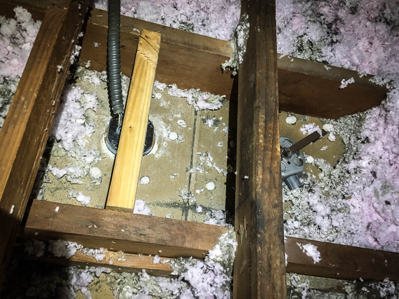

What a pain. After much eyeballing, I realized the old box was off-center by about a foot, so I just drilled a new hole and did everything fresh (using the existing wiring).
I bought a metal support bracket, but found the beams were too close together for it to fit (measure once?). I just went the 2x6 route with a pair of 3" screws on each side, with the junction box screwed in from below with the same screws.
I was delighted to find that the previous owner kept the old-*** insulation and just blew new stuff on top...Maybe it doesn't matter.
After much mucking about, I have a smoothly spinning fan that doesn't wobble and a very sweaty education. Thanks, all!

OP, not to rain on the parade, but your cable connection method to the box has a few safety issues.
First, there is no ground connection to box from the metal jacket of the bx (or greenfield?).
Secondly, the exposed conductors could get damaged from activity in the attic and even energize the box and connected fan – waiting to zap someone.
You need to pull the fan and properly connect the cable. You could keep the same box, but need to move the blocking an inch or so to have clearance around the ko so you can get a connector installed.
Or try as side entry - may have to mine out a little bit of sheet rock for clearance

He can probably gain a few inches of Greenfield somewhere, swivel the box a bit to give clearance to the KO...and then yes, use the 90 connector FIB linked.
OP - In the wiring system you have... the "Greenfield" flex provides Grounding continuity... W/O continuity, as you currently show it, it is a major potential hazard.
My only concern is.... having done alot of electric work for years as a Contractor... that he drilled his new hole SO far from the source, that his flex may be "Too" short.
Now, he can PROBABLY gain a few sufficient inches by working backwards on the flex securement...
But, if not...
Still, his wires showing in the box are long enough that he can get a greenfield coupling and extend it a few inches, using the 90 connector above.
In all cases, it needs to be both grounded by bonding, AND correctly connected to prevent chafe and insulation damage.
Sorry OP, more sweat will be needed to protect your Family and Home.
But, you knew it was not connected properly.
Now, Fix it.
Good job on the support cross member though. !!!

No it does not. That's just an old style "new work" box. Absolutely not up to the task of holding a fan.
Its hard to tell with all the insulation, but it looks like someone used an emt connector for bx.
Good eyes. Looks like that to me too.

Yep, this NEEDS to be fixed. If it were me, and the BX is too short, I'd just end the BX in a box that it reaches, and splice that to a new piece that goes to the fan.
Now, Fix it.
