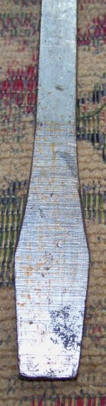

Well I got my replacement SDS-33 back from Snap-on today. The replacement that they sent me has the same defect as the one that I returned.
No harden tip on this one either.
Who's got a pic of an SDS-33 with the correct hardened tip?

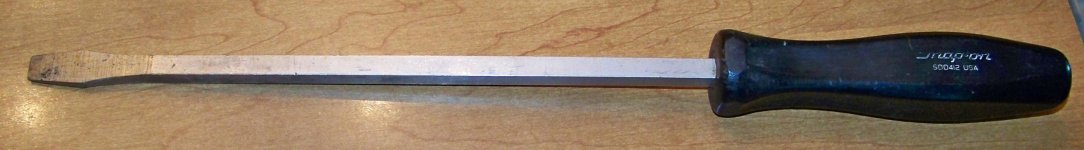

What defect? Twenty year old Snap On....same screwdriver and the same tip as yours.

Look at the pics posted by rshadd. I think his looks OK and probably doesn't need to be filed on the end. The one posted in the original post doesn't look too good because the end comes to a point. It apparently missed a final grinding step. But neither of rshadd's drivers look like that.
Actually, now that we have more info, it looks like rshadd didn't even need to warranty his first driver. Look at how his first one actually is flat on the end because it had the final tip grinding that was missed on the OP's driver.
I think the OP got one that was legitimately bad because the tip wasn't flat. Everyone else now may be concerned over nothing, since it looks like that size of driver just is made differently.
I think Williams didn't handle this well. They should have pointed out that the SDS-33 driver is just different than the other sizes. It looks like people here may blowing this out of proportion because Williams didn't clarify.
It now appears we shouldn't expect the tip of this driver to look like the other sizes with the vapor blasting marks found on other sizes.

rshadd that driver looks just like mine. perfectly functional and exactly how it is supposed to look. These drivers are not blasted just ground on the end.

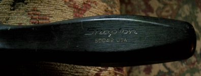

SDD12 is a round shank screwdriver. The SDD412 is the original screwdriver that the Williams SDS-33 replaces. Square shank and it doesn't have the blasted tip. The Williams catalog doesn't mention the lack of a blasted tip, but it even says, square shank (NOT round like the SDD12).
The picture below is the Snap On version. Same screwdriver, square shank and 12" long. the only difference is the Snappy handle of 20 years ago is slightly long than the newer Williams. Blade is the same.

You see, I was under the impression that the SSD-33 was supposed to have the "vapor blasted" hardened tip like the of drivers in the set. If that's not the case, I can accept
that.
I was merely looking at the visual differences between the driver tips and assumed they should all be the same.
I still think it's a bit odd that when I wrote to Snap-on and included pictures they acknowledged the defect with the driver and offered to replace it. Two Snap-on reps told me about the manufacturing defect with SDS-33 driver, but perhaps they were referring to the tips not being ground.
My guess is that they never bothered to look at the pictures that I sent, told me to return it and then let the warranty dept. deal with the (non) issue. The warranty dept. probably never read the email trail that I had included with the return and simply just exchanged it. I think this was simply poor communication on Snap-on's part.
I would have accepted, "that's just they way they are" or "the tips on the SDS-33 are different from the smaller drivers" as an answer.
Truth be told, its a driver I rarely use. It'll get thrown back in the toolbox and ignored until I need a small pry bar, since I don't ever see screws that size.
I regret exchanging the driver since there really wasn't anything wrong with it and the lettering on the handle of the driver I returned was perfect and the one I got back isn't.
