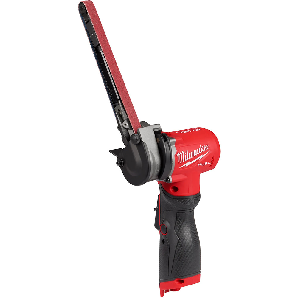

I would think using a bandfile would be very helpfull. Best of luck though
Thank you for the suggestion. I ordered the Wen variable speed and 3M belts. I tried using flap discs on a 4” grinder but it was too aggressive and I did not want to damage the original casting , so I stopped and will try again with the band file. Thanks again.
